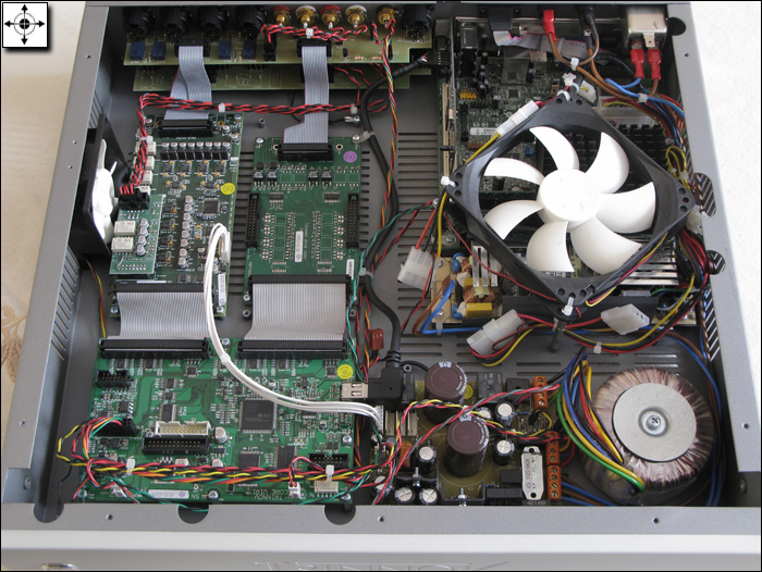

For large multi-way speaker systems with active crossovers, Trinnov's intelligent crossover alignment dramatically reduces the effort required to set up gain and delay for each driver. While a 2-way system can be managed with a single ST2, 3-way and 4-way systems can be accommodated by combining two ST2s. Let’s now inspect the optimizer module’s main features. Based on its acoustic measurements, the optimizer automatically aligns the relative output levels of each speaker drive unit and where necessary applies delays to time-align the system. This setting can be adjusted separately for the front and optional surround speakers in the settings panel. It uses state-of-the-art time frequency algorithms to analyze the calibration measurements and distinguishes between/compensate for direct sound, first reflections, reverberation and room modes. The optimizer adjusts the loudspeakers’ frequency response for both amplitude and phase to achieve tonal balance corrections with correct time domain functions to deliver a high-resolution stereophonic landscape with well-focused phantom images. The target curves define the filters which will achieve the desired frequency response as input by the target curve the user selected. Phase and group delay may also be defined separately. Other fine-tuning options are available to customize the room correction algorithms.
6moons.com/audioreviews/trinnov/1.html
    KB 399.2 · צפיות: 576
צפה בקובץ המצורף 50404
